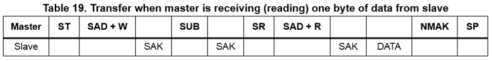

I am using NHS3100 connected with an acceleration sensor (LIS3DH) using I2C interface.
But it is not working properly.
Here is the pin connection according to the attached "NHS3100 schematic.png":
VCC: VDDBAT (3.3V)
GND: GND
SDA: PIO5 --- P05
SCL: PIO4 --- P04
I am using "app_demo_dp_tlogger" to add my I2C:
1, Init I2C
2, use "Chip_I2C_MasterSend" and Chip_I2C_MasterRead to send/read data to/from sensor.
But it didn't get anything.

1, ***
"Chip_I2C_MasterCmdRead" is provided by the lib i2c_nss. As the function explain:
/* Transmit one byte and receive an array of bytes after a repeated start condition is generated in Master mode.
 * This function is useful for communicating with the I2C slave registers
And here is from my sensor's data sheet as below, so I think this API can be use to read my I2C slave device register and it DID. As my understanding, "Chip_I2C_MasterCmdRead" is equivalent to "Chip_I2C_MasterSend" then "Chip_I2C_MasterRead".
The problem is what I mentioned in my previous reply,
1.1 send data to I2C slave to get the register data of the sensor by call "Chip_I2C_MasterCmdRead";
1.2 send data to I2C slave to write the register of the sensor by call "Chip_I2C_MasterSend";
1.3 send data to I2C slave to get the register data of the sensor again by call "Chip_I2C_MasterCmdRead";
If I just have only item 1.1 (or 1.2, or 1.3) to test, it is ok for the correct operation and result.
But when I have the three items to test together, it is failed to operate the item 1.2 or item 1.3 for the results.
The API function never return for item 1.2 or item 1.3 and it looks the stat is always I2C_STATUS_BUSY from my observation.

Kan_Li
Hi Arna,
Thanks for the information! I think the cause is due to there is a repeat start condition during the process, so you should use Chip_I2C_MasterCmdRead(), which is transmiting one byte and receive an array of bytes after a repeated start condition is generated in Master mode. and you could not use a combination of Chip_I2C_MasterSend() and Chip_I2C_MasterRead() to replace Chip_I2C_MasterCmdRead(), because there is no repeat start condition in that case.
Hope that makes sense,
Kan
