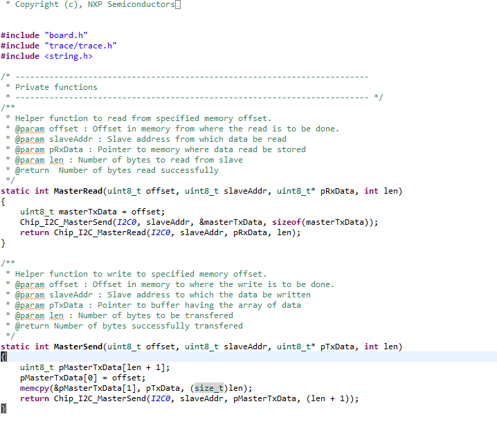

I am using "app_demo_dp_tlogger" to add my I2C:
1, Init I2C
2, use "Chip_I2C_MasterSend" and Chip_I2C_MasterRead to send/read data to/from sensor.
But it didn't get anything.

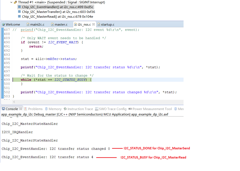

From my observation, the routine stuck in the while statement in the funciton "Chip_I2C_EventHandler":
/* Wait for the status to change */
while (*stat == I2C_STATUS_BUSY) {
I didn't see I2C_STATUS_DONE which will be set in the function "I2C0_IRQHandler" => "Chip_I2C_MasterStateHandler" as my own understand.

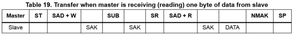

And here is from my sensor's data sheet as below, so I think this API can be use to read my I2C slave device register and it DID. As my understanding, "Chip_I2C_MasterCmdRead" is equivalent to "Chip_I2C_MasterSend" then "Chip_I2C_MasterRead".

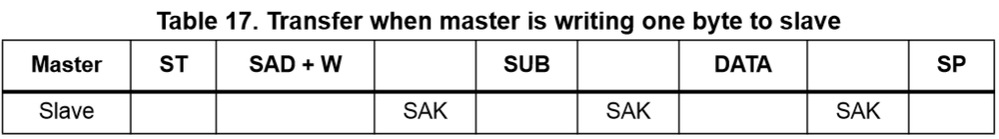

1.2 send data to I2C slave to write the register of the sensor by call "Chip_I2C_MasterSend";

And here is from my sensor's data sheet as below, so I think this API can be use to read my I2C slave device register and it did. As my understanding, "Chip_I2C_MasterCmdRead" is equivalent to "Chip_I2C_MasterSend" then "Chip_I2C_MasterRead".

Here is my debug screen:
I am going crazy :smileysad::((
Any idea to dig out  the cause of the problem?

Thanks for the information! I think the cause is due to there is a repeat start condition during the process, so you should use Chip_I2C_MasterCmdRead(), which is transmiting one byte and receive an array of bytes after a repeated start condition is generated in Master mode. and you could not use a combination of Chip_I2C_MasterSend() and Chip_I2C_MasterRead() to replace Chip_I2C_MasterCmdRead(), because there is no repeat start condition in that case.

I printf some debug logs and found sometimes I2C0_IRQHandler called but sometimes NOT.
Now I can read/write the register of the sensor by calling the I2C API funciton "Chip_I2C_MasterCmdRead"/"Chip_I2C_MasterSend" respectively.
 But the problem I met is that I canNOT operate the I2C by calling  the API functions above repeatedly.
My test items/steps are:
  1. send data to I2C slave to get the register data of the sensor by call "Chip_I2C_MasterCmdRead";
  2. send data to I2C slave to write the register of the sensor by call "Chip_I2C_MasterSend";
  3. send data to I2C slave to get the register data of the sensor again by call "Chip_I2C_MasterCmdRead";
If I just have only item 1 (or 2, or 3) to test, it is ok for the correct operation and result.
But when I have the three items to test together, it is failed to operate the item 2 or item 3 for the results.
The API function never return for item 2 or item 3 and it looks the stat is always I2C_STATUS_BUSY from my observation.

Why using Chip_I2C_MasterCmdRead()? You should use Chip_I2C_MasterRead(). Just as below:
I think your issue is related with your driver implementation, please kindly check on your side. You should have the SDK code in the following link, right?
