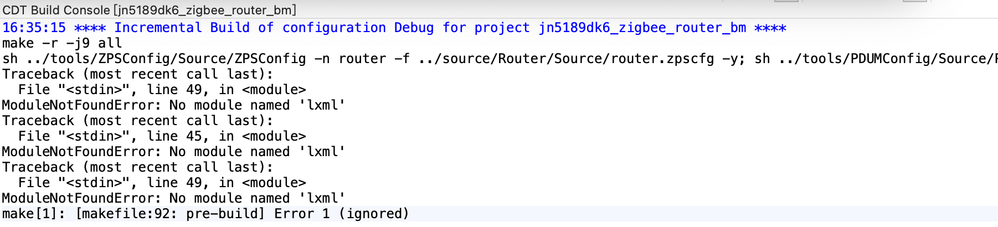

Heart that there is new release for  ararch64 , I try the example jn5189dk6_zigbee_router_bm. The problem is still there.

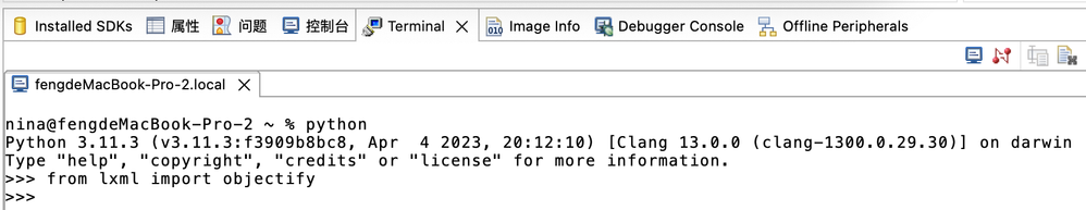

I can use python on terminal.
terminal: 'lxml' python worksterminal: 'lxml' python works
also terminal in MCUXpresso IDE.
termina: 'lxml' python workstermina: 'lxml' python works
build the example jn5189dk6_zigbee_router_bm.
tools build does not work. (ZPSConfig)
still  ModuleNotFoundError:No module named 'lxml'.
build tool errorbuild tool error
no pdum_gen.hno pdum_gen.h
Do I miss sth.
Look forward to your kind advice.

This error may be due to some missing python modules, could you please try installing lxml module for python? You can try using:
pip install lxml
Eduardo.

Nina
thank you first. u see pic 1, that I have installed lxml, but the error still there.

EduardoZamora
What is your MCUXpresso IDE version? Which SDK version are you using?
Could you please confirm that you have correctly added Python to the system's PATH? Did you install pycryptodome python module?
Eduardo.

Nina
thanks.
I use the MCUXPressoIDE_11.8.0_1165.aarch64.pkg.
MCUXpresso IDE v11.8.0 [Build 1165] [2023-07-26]
SDK_2_6_12_JN5189DK6
nina@fengdeMacBook-Pro-2 ~ % which python
python: aliased to /Library/Frameworks/Python.framework/Versions/3.11/bin/python3.11
nina@fengdeMacBook-Pro-2 ~ % pip install pycryptodome
Requirement already satisfied: pycryptodome in /Library/Frameworks/Python.framework/Versions/3.11/lib/python3.11/site-packages (3.17)
[notice] A new release of pip is available: 23.1.2 -> 23.2.1
[notice] To update, run: pip install --upgrade pip

EduardoZamora
By any chance, do you have multiple Python versions installed on your system? Also, please consider upgrading pip.
Eduardo.

Nina
Thanks very much.
I update to macOS Monterey(12.7).
add path "/usr/local/bin" to MCUXpresso IDE Paths.
restart IDE.
it works.
