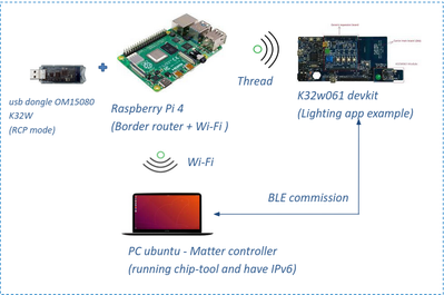

We are creating big project following Matter open source (project-chip/connectedhomeip ) base on Hardware NXP K32W061.
The first of all, we are try to build and run lighting app example on NXP K32W development kit but have been stuck.
Please help to get summarize content as below:
Lighting app demo (BLE - Thread):
a. Topology:
- NXP K32W061 development kit (Lighting app example)
- Raspberry Pi4 (open thread border router)
- USB dongle OM15080 K32W (RCP mode)
- Ubuntu’s PC (Matter controller)
b. Run example
a. Step 1: Commission process:
1. On Matter controller (Ubuntu's PC), runs:
#  ./chip-tool pairing ble-thread [NODE-ID] hex:[RAW-DATASET] [setup-pin- code] [discriminator]
In there:
- NODE-ID: you can assign any node id
- RAW-DATASET: you can get from ot-ctl
- setup-pin-code and discriminator: you could look in the Preparing accessory device section
2. On K32W development kit:
- Already plugin expansion board: OM15082
- Push the USERINTERFACE button on the K32W board. This will start the BLE advertising process;
