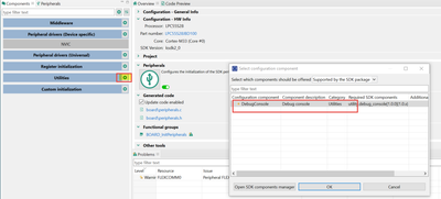

Just kindly reminder, you can create PRINTF by Config Tool:

Yes I realize I can get printf.  It's sprintf that I'm looking for.
I don't want to edit my copy of fsl_debug_console.c/h to make the necessary function accessible externally, otherwise my changes will get overwritten whenever I update my copy of the SDK.
