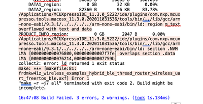

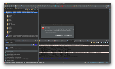

Athena
Hello.
Firstly, this is the error that would appear once I've debugged it

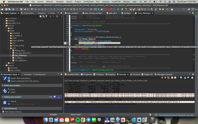

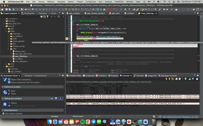

And then looking into the details of the warning, pictures below shows the warning sign in the particular line.
How do I solve this problem? So I can embed the BLE application to my board.
Thank you.
10,175 Views
nxf56274
The first picture says that the program file doesn't exist. Did you compile the program correctly?

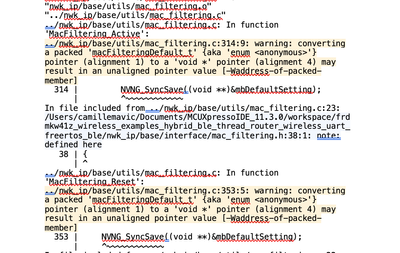

nxf56274
The picture I post has shown the error. In file 'mac_filtering.c', there is redundant character ' ` ' in file.

Athena
Hello, thanks I've already removed it! However, there is still an error but I cannot decipher what it means.
