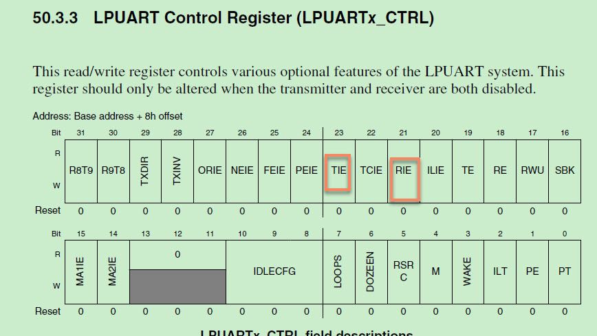

   If you want to enable both the TX and RX interrupt, you just need to enable both LPUARTx_CTRL[TIE] and LPUARTx_CTRL[RIE], more details, please check the CTRL register description in the KL82 reference manual.
So, you can use this API:
LPUART_EnableInterrupts(base, kLPUART_TxDataRegEmptyInterruptEnable | kLPUART_RxDataRegFullInterruptEnable);
