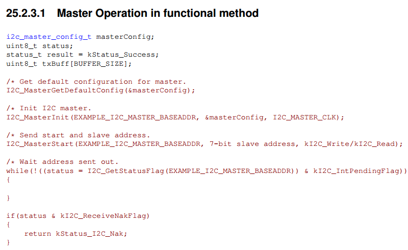

I am using KSDK 2.0 for FRDM-K22F board.
Example in API for I2C Driver Master Operation references a function called I2C_GetStatusFlag which is not documented or used anywhere in.
Where can I find this function?
It's in section 25.2.3.1 of the "Kinetis SDK v.2.0 API Reference Manual"

Hi Brad,
The API is no longer provided and there was misalignment between the document and the example code. With current SDK packages, please refer to the driver examples provided in the boards/<BOARD>/driver_examples/i2c directory. They are fully tested.  We will fix these unalignment between documentation and example code in next release. Sorry for the inconvinience.
