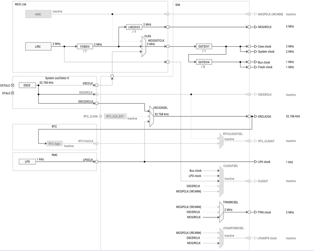

Thanks Robin, that may be what I'm running into.  It is unclear though (at least to me) what the phrase "unless it was configured in RTC OSC" means.  I do have the RTC running during VLLS3 in order to keep accurate time.  But this device doesn't have the dedicated RTC OSC pins EXTAL32 and XTAL32.  So I am using the system OSC pins ETAL0 and XTAL0 with a 32.768Khz clock to drive the clock into the RTC module.  So does this mean I need to re-configure the clock or not?  Below is the clock configuration of the chip just before going to VLLS3.
If I do need to re-configure the clock, doesn't that mean that the RTC is going to be slightly inaccurate as it briefly turns OFF during wake and then is re-enabled a (very) short time later.  But it doesn't take much to cause a significant error over multiple wakeup events.

To anyone else who stumbles across this, I have confirmed with NXP that the RTC clock is gated on wake from VLLS3 (maybe from other states) to RUN for exactly 125ms (4096 cycles of 32.76Khz clock).  So to keep more accurate time over multiple wake up events you need to add one to the RTC seconds register once every 8 times the micro goes through this wake up sequence.
James.
