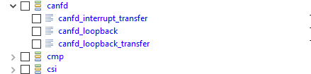

The FLEXCAN_FDInit() is the init function for the CAN with FD protocol, you can also find an example under canfd
