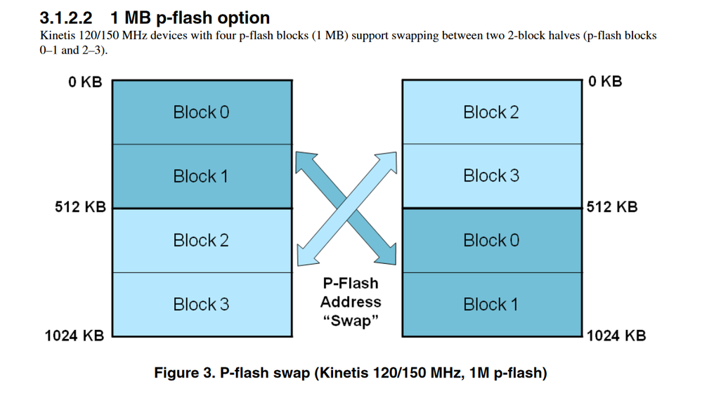

We are doing developement on K64 and it will be replaced with K63 in future.

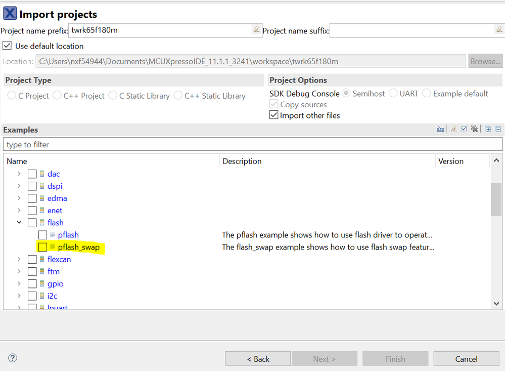

We are currently implementing FOTA and I read many posts related to swap feature of flash memory. Yet I coudn't find project example related to this freature in MXUXpresso.
Please help me with this.
As per my understanding, for K64 we have 1MB flash which is divided in 2 p-flash blocks of 512bytes each. We will have last two block sectors as swap memory. Is this correct?

Hello
The Kinetis with 1MB has four p-flash blocks. You can find more detailed information about the flash swap in this application note: https://www.nxp.com/docs/en/application-note/AN4533.pdf
Regarding the examples, we don’t have a specific example for K64/K63 devices however in the twr-k65 or twr-k60 SDK you can find a flash swap example you can use as a reference.
Let me know if this is helpful, if you have more questions do not hesitate to ask me.
