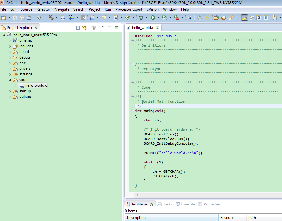

I followed all the steps to generate and donwload the file "SDK_2.3.1_TWR-KV58F220M" (MCUXpresso SDK and not KSDK).
Now I am following the steps from the document "Getting Started with MCUXpresso SDK". I try to run and debug the 'Hello word' example, but I have not been able to continue from this point (please see the attached picture)
As it is shown in the appendix B of this document, TWR-KV58F220M board has CMSIS-DAP as debug interface, however, the 'Hello word' example is not charged in 'GDB Open Debbuggin' (please see the attachment). What am I doing wrong.
And if I try with 'GDB PEMicro Interface Debugging', I get the following error message: Exception occurred during launch. Reason: error in services launch sequence.

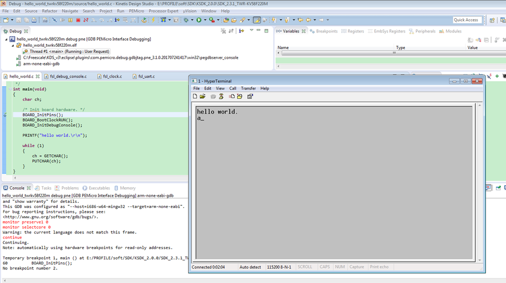

   4. Open the SDK helloworld code.
   KDS project folder:SDK_2.3.1_TWR-KV58F220M\boards\twrkv58f220m\demo_apps\hello_world\kds
  1)  Use the KDS open it, and build the project
   2) open the debug configurations, choose the GDB PEMicro Interface debugging.
The opensda debug is entered in.
 Now, open a COM Terminal to test the function.
Then click the resume button in KDS debug interface.
The above is the test result.

Thank you so much for your help. I appreciate your detailed steps. Everything went perfect.
