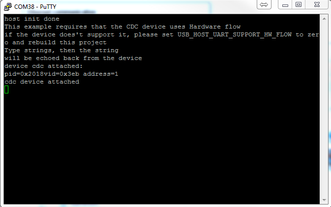

Hello Daniel
Here is what i see in the console:
Whatever i type in the console is not echoed back.
i tried to follow the code to see where it breaks, and what i found is that i get a kStatus_USB_TransferFailed
in the USB_HostCdcDataOutCallback and USB_HostCdcDataInCallback
From what i understand of the code, this seems to indicate that no byte where transfered, but i am not sure why.
Any help would be greatly appreciated!

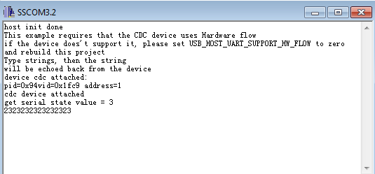

Hi Christian:
Have you solved this issue? I just did a quick test with this demo.  Frdm-k66 as a usb cdc host, and TWR-K65 as a usb cdc device. It works on my end. please see below picture. What's you settings?
