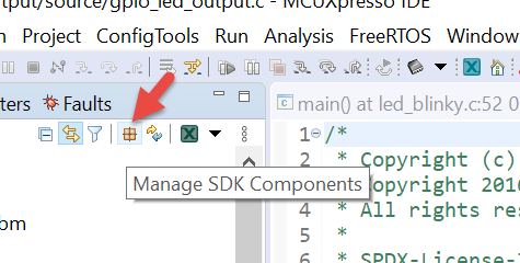

ZhangJennie
From your description, there is no problem on other SDK demos but only on "lpcxpresso54628_sctimer_pwm_with_dutycyle_change"
Thus I suggest you import this project source code to a "good" sdk demo.  it's not difficult.
- import a hello world demo project.
- add same driver component of "lpcxpresso54628_sctimer_pwm_with_dutycyle_change" to your demo project, from below
- replace the source code of "lpcxpresso54628_sctimer_pwm_with_dutycyle_change" to your demo project source code.
- rebuild. see how it works.
