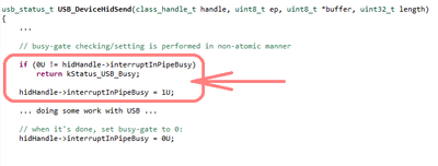

olex
Hi Edwin,
Below is an excerpt from USB_DeviceHidSend() function implementation:olex_0-1759312418535.png
main() cycle periodically calls USB_DeviceHidSend()
and USB ISR also calls USB_DeviceHidSend() periodically
USB ISR can occur/intervene at any arbitrary point in main() execution, including the point between checking busy-flag and setting it to 1.
As a result, we will get an inconsistent "parallel" code execution.
And SDK middleware has many functions similar to USB_DeviceHidSend() described. The same applies to example applications.
My proposal is not to change the drivers code, but to change the way the driver functions are used in the application.
I want to disable USB interrupts during USB_DeviceHidSend() is called from the context of main().
Is this a normal idea?

EdwinHz
Hi @olex,
Thanks for the explanation, I understand.
I hypothesize that your modification would be useful for the mentioned cases where a USB ISR can occur during main() execution.
I don't think it will cause any unwanted behavior but rather will add robustness to the application.

The following code is executed in the main() context:
usb_status_t USB_DeviceHidSend( class_handle_t handle, uint8_t ep, uint8_t* buffer, uint32_t length )
	usb_device_hid_struct_t* hidHandle;
	usb_status_t error = kStatus_USB_Error;
	if ( NULL == handle )
		return kStatus_USB_InvalidHandle;
	hidHandle = (usb_device_hid_struct_t*)handle;
	if ( 0U != hidHandle->interruptInPipeBusy )
		return kStatus_USB_Busy;
	hidHandle->interruptInPipeBusy = 1U;
	if ( 0U != hidHandle->interruptInPipeStall )
		hidHandle->interruptInPipeDataBuffer = buffer;
		hidHandle->interruptInPipeDataLen = length;
		return kStatus_USB_Success;
	error = USB_DeviceSendRequest( hidHandle->handle, ep, buffer, length );
	if ( kStatus_USB_Success != error )
		hidHandle->interruptInPipeBusy = 0U;
	return error;
And the following code is executed under USB-ISR:

If during main() execution an interrupt is triggered at this point:
, and this interrupt handles kUSB_DeviceClassEventClearEndpointHalt event, then the pointer to a some buffer will be saved in interruptInPipeDataBuffer and interruptInPipeDataLen fields.
And this information will be "hidden/waiting" until the next pair of events kUSB_DeviceClassEventSetEndpointHalt + kUSB_DeviceClassEventClearEndpointHalt. Which will unexpectedly send some content to the host (which at that moment will be in that buffer).
I understand that probability of such event is very low, especially in the case of a keyboard. But a similar operating principle is used in many classes/examples: phdc, com-port, etc. That's why I came up with idea of ​​using a protection in the form of disable+enable USB interrupts inside main().
