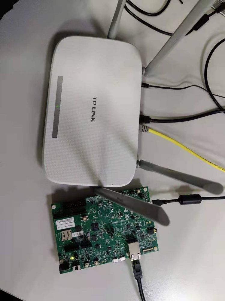

I've run the netx_duo_iperf and lwip_iperf demos on the MIMXRT1060 for testing(as Fig 1 shows).
Fig 1

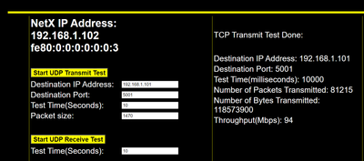

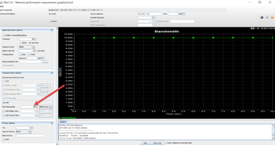

I find that the UDP receive rate is determined by the rate of transmission of the iperf tool actually, and it's proved by testing both above two demos.
For instance, the below Fig 2 shows the Bandwidth when the MIMXRT1060 enters the UDP server mode (RX only test) mode.
Fig 2

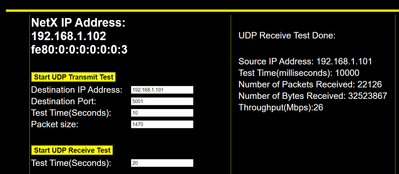

And Fig 3 shows the UDP receive Test when running the netx_duo_iperf demo.
Fig 3
I also did TCP protocol test like the below figure shows.
Fig 4
