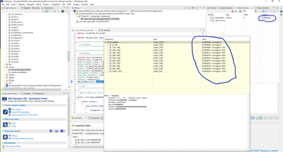

2,678 Views
xiangjun_rong
 Based on the MCUXpresso ver11.x tools and mscan_interrupt_transfer example in SDK package of LPC54018, with the code:
#define MSG_RAM_SIZE 1024
volatile bool txComplete = false;
volatile bool rxComplete = false;
mcan_tx_buffer_frame_t txFrame;
mcan_rx_buffer_frame_t rxFrame;
uint8_t tx_data[CAN_DATASIZE];
uint8_t rx_data[CAN_DATASIZE];
mcan_handle_t mcanHandle;
mcan_buffer_transfer_t txXfer;
mcan_fifo_transfer_t rxXfer;
uint32_t txIdentifier;
uint32_t rxIdentifier;
SDK_ALIGN(uint8_t mmsgRam[MSG_RAM_SIZE], 1U << CAN_MRBA_BA_SHIFT) = {1U};
after compiling/linking,The mmsgRAM[] array is distributed tom 0x2000_0000, the txIdentifier variable is located at 0x2000_0620, obviously, the compiler is  wrong to allocate the variable.
For the line SDK_ALIGN(uint8_t mmsgRam[MSG_RAM_SIZE], 1U << CAN_MRBA_BA_SHIFT) = {1U};
the mmsgRam[] array must be allocated with 64K Byte boundary, so I suppose the compiler is not capable to handle so large range.
As a workaround, you have to allocate an absolute memory space for the mscan memory with 64K byte boundary such as 0x2000x_0000, which will not overlap with stack, global variable space, heap and bss, as the mscan example has done.
Hope it can help yuou
XiangJun Rong
