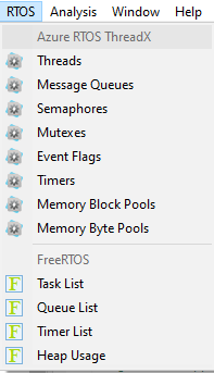

The Thread Aware Debugging (TAD) tool is a useful and powerful instrument to debug the Azure RTOS application. With MCUXpresso IDE 11.4.1, we can show the Azure RTOS ThreasX TAD views. We take the evkmimxrt1060_threadx_demo as example.
Theads view shows the threads in a table, we can see the priority, state, stack usage for each thread.
Message Queues view shows the message queues in a table

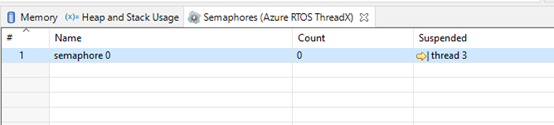

Semaphores view shows the semaphores in a table
Suspended means the threads that are suspended and waiting for access to current resource.

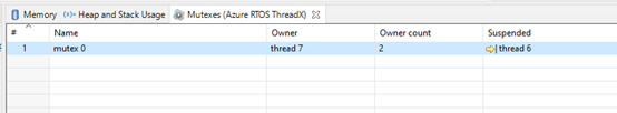

Mutexes View shows the information about mutexes used inside the application

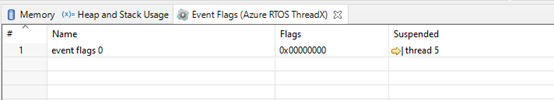

Event flags view shows the event flags in a table. Suspended : threads that are suspended and waiting for access to current resource.
