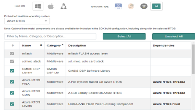

Now Azure RTOS is integrated into MCUXpresso SDK2.8.5 and is available from our SDK builder site (https://mcuxpresso.nxp.com) and also directly from MCUXpresso IDE. Support is currently available for i.MX RT1050, i.MX RT1060 and i.MX RT1064 MCUs.
Please select Azure RTOS before you download it.
