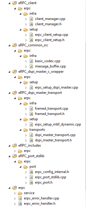

This tutorial is introducing the eRPC (embedded remote procedure call) open-source project.
The eRPC (Embedded Remote Procedure Call) is a Remote Procedure Call (RPC) system created by NXP. An RPC is a mechanism used to invoke a software routine on a remote system using a simple local function call. The remote system may be any CPU connected by an arbitrary communications channel: a server across a network, another CPU core in a multicore system, and so on. To the client, it is just like calling a function in a library built into the application. The only difference is any latency or unreliability introduced by the communications channel.
Important links:
The eRPC is supporting multicore and multiprocessor types of applications.
Where to find eRPC examples
  • Plenty of eRPC multicore and multiprocessor examples can be found in NXP MCUXpressoSDK packages. Visit https://mcuxpresso.nxp.com to configure, build and download these packages.
    To get the board list with multicore support (eRPC included) use filtering based on Middleware and search for 'multicore' string. Once the selected package with the multicore middleware is downloaded, see
    <MCUXpressoSDK_install_dir>/boards/<board_name>/multicore_examples for eRPC multicore examples (RPMsg_Lite or Messaging Unit transports used) or
    <MCUXpressoSDK_install_dir>/boards/<board_name>/multiprocessor_examples for eRPC multiprocessor examples (UART or SPI transports used).
    eRPC examples use the 'erpc_' name prefix.
  • Another way of getting NXP MCUXpressoSDK eRPC multicore and multiprocessor examples is using the mcux-sdk Github repo. Follow the description how to use the West tool to clone and update the mcuxsdk repo in readme Overview section. Once done the armgcc eRPC examples can be found in
    mcuxsdk/examples/<board_name>/multicore_examples or in
    mcuxsdk/examples/<board_name>/multiprocessor_examples folders.
    You can use the evkmimxrt1170 as the board_name for instance. Similar to MCUXpressoSDK packages the eRPC examples use the 'erpc_' name prefix.

Thank you for reply Dusan
 that was the information i was looking for, i have created C wrapper for TCP  , after couple of fixes in erpc,  it works fine .
My next step is to replace TCP layer with rpmsg .
Thank you again
Chandini

Hi Dusan , Marek
What i am planning :
use rpmsg-lite on both M4(freertos) and A7(Linux)
What i need:
RPMSG C warrper (under erpc_c/setup) which can be use on both M4 and A7 side
RPMSG Transport Layer (under erpc_c/transports) which can be use on both M4 and A7 side
Questions i have:
Could please tell me , Do you have any transport layer for that ?
   or
Do we need to refer rpmsg-python and write similar like that ?
Any suggestions will be so helpful
Thank you guys
Chandini
Hi, i understand you.
You need create new one (and with pull request on github you can add it to our repository if you want).
On Linux side you can use /dev/ttyRPMSG (if it is present in system).
for example create new transport here erpc_c/transports with:
init can looks like: int fd = open("/dev/ttyRPMSG", O_RDWR);
send : write(fd, buffer, buffer_size);
read: size_t size = read(fd, buffer, expected size);
If there is no device named like this, you can be inspired from python code. RPMSG is not my cup of tea. I don't know how it should be used on Linux. I will forward your question to Marek.

Thank you for the quick reply! I cloned the dev branch. I see that the erpc_c directory structure is way different than the example provided with the Kinetis SDK. Which one is preferable?
Evgeny
Hi evgenyerlihman‌,
Prefered code is always on github on develop branch. Once this code will meet our requirements for new release we will merge it into master branch and we will provide also binaries of application. These updates on develop branch are more often than releases of Kinetis SDK. If some existing eRPC transport will not met version with transport used in Kinetis SDK you can compare old eRPC transport with newer one, or look on file changes in git repository.
Hey Dusan,
When i use the erpcgen.exe that i built, i get the same error on the smac.erpc example:
error: file smac.erpc:135:5: syntax error, unexpected identifier, expecting '}'
The directory structure that i was referring to is the erpc_c from the repository and:
From the SDK example. Which directory structure is the "right" one? Would it be safe to use the newly generated files (by me) with the SDK example code?

Hi Evgeny,
first of all: Are you using smac.erpc from develop branch (and app built from that branch)? For me is this version working.
Right now version of erpcgen app and rest of eRPC code is connected. That means if you want use newer erpcgen app you built from github, you should and have to copy github erpc_c/* files from github into your example. After than you can regenerate code with newer erpcgen app, update application (erpc init + transport) functions and everything else should work. Otherwise if you will not update erpc_c files you have to use provided erpcgen app.
Look at the bottom of this page: Getting Started · EmbeddedRPC/erpc Wiki · GitHub  Should be pretty up to date for newer erpcgen version.
I am not sure but on newest commit spi could get changed so you can use older implementation instead.

I am sorry for the first question, i do see the erpc_setup_mbf_static.cpp in the repository. The thing is that i am basing  my code on the examples provided in the MCUXpresso SDK - frdmk66f_multiprocessor_examples_erpc_server_matrix_multiply_spi & frdmk66f_multiprocessor_examples_erpc_client_matrix_multiply_spi. Which have a very different directories structure from the code in the repository.
So my question is, again, should the SDK examples directories structure should be used or the repositories? ANd why are they so different?
Evgeny
Hi Evgeny, this looks like MCUExpresso project files/IDE issue. Top layer of folder names should be virtual directories, which will be not presented there in future. In your package on your disk should eRPC have similar directory structure as on github. Github directory structure is preferred.
