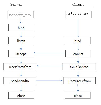

3. Using sequential API
 As shown in the below figure, the steps for establishing a TCP connection on the client side are the following:
  • Create a connection using the netconn_new() function;
  • Connect to the address of the server using the netconn_connect() function;
  • Send and receive data by means of the netconn_recv() and netconn_write() functions.
  • Close the connection by means of the netconn_close() function.
The steps involved in establishing a TCP connection on the server side are as follows:
  • Create a TCP connection with the netconn_new() function;
  • Bind the server to an address using the netconn_bind() function;
  • Listen for connections with the netconn_listen() function;
  • Accept a connection with the netconn_accept() function. This call typically blocks until a client connects with the server.
  • Send and receive data by means of netconn_write() and netconn_recv().

From the tcpecho thread, we can see
First, one new TCP connection was called with parameter NETCONN_TCP  by API netconn_new.
#define netconn_new(t)                  netconn_new_with_proto_and_callback(t, 0, NULL)
struct netconn *
netconn_new_with_proto_and_callback(enum netconn_type t, u8_t proto, netconn_callback callback)
  struct netconn *conn;
  API_MSG_VAR_DECLARE(msg);
  API_MSG_VAR_ALLOC_RETURN_NULL(msg);
  conn = netconn_alloc(t, callback);
  if (conn != NULL) {
    err_t err;
    API_MSG_VAR_REF(msg).msg.n.proto = proto;
    API_MSG_VAR_REF(msg).conn = conn;
    err = netconn_apimsg(lwip_netconn_do_newconn, &API_MSG_VAR_REF(msg));
    if (err != ERR_OK) {
      LWIP_ASSERT("freeing conn without freeing pcb", conn->pcb.tcp == NULL);
      LWIP_ASSERT("conn has no recvmbox", sys_mbox_valid(&conn->recvmbox));
#if LWIP_TCP
      LWIP_ASSERT("conn->acceptmbox shouldn't exist", !sys_mbox_valid(&conn->acceptmbox));
#endif /* LWIP_TCP */
#if !LWIP_NETCONN_SEM_PER_THREAD
      LWIP_ASSERT("conn has no op_completed", sys_sem_valid(&conn->op_completed));
      sys_sem_free(&conn->op_completed);
#endif /* !LWIP_NETCONN_SEM_PER_THREAD */
      sys_mbox_free(&conn->recvmbox);
      memp_free(MEMP_NETCONN, conn);
      API_MSG_VAR_FREE(msg);
      return NULL;
  return conn;
Then, the newly created connection is then bound to port 7 (echo protocol) by calling the API function netconn_bind.
Next, the application starts the listening process on the connection by calling the API function netconn_listen.
In the infinite while(1) loop, the application waits for a new connection by calling the API function netconn_accept. This API will block the application task when there is no incoming connection.
When there is an incoming connection, the application can start receiving data by calling the API function netconn_recv. Incoming data are received in a netbuf.
Application can get the received data by calling the netbuf API function netbuf_data.
