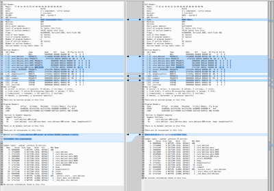

I want to add some information to my previous post.
I took the erpc_matrix_multiply_mu example from the SDK.
I tried and run objdump and readelf before and after running mcux-fixelf.
output of 'objdump -x', on the left before, and on the right after executing mcux-fixelf:
output of 'readelf -a', on the left before, and on the right after executing mcux-fixelf:
I see these differences:
  1. EXEC_P flag is removed
  2. type become NONE instead of EXEC
  3. alignment of every section is set to 1
  4. symbol table address are offsets of 0x20000000 (I don't know if this is a consequence of some other action)
  5. type of .core_m4slave.ARM.exidx section changed from ARM_EXIDX to PROGBITS
  6. flags of .core_m4slave.ARM.exidx section changed from AL to A
  7. removed unwind sections
For each individual item on this list I need to answer the following questions:
  1. why to do it?
  2. what problem should it solve?
  3. Is it strictly required or optional?
  4. How to do this using linux command line tools and those provided by the toolchain?
I wonder if point 5, 6 and 7 are applied only to .core_m4slave.ARM.exidx or all section with similar attributes.

cristiantepus
Historically, in IDE, we have a model of the multicore projects that are included in the SDK pack. This consisted into secondary project generating an image for the secondary core, then primary core project links the secondary’s image sections inside its own final image. The first core’s runtime model is then responsible to copy the secondary image to its own space and start execution in order to allow the second core to boot and execute.
Now, coming back to the multicore image construction, along the path some limitations or feature updates in the toolchain prevented the initial above mentioned approach and some “tweaks” were required to still keep this example’s model:
  • Linker updated some years ago its input file linking model in a way that executables were no longer allowed to be directly referred as “input files” for linking stage (see https://sourceware.org/bugzilla/show_bug.cgi?id=26047). At that time, the easiest workaround was to remove the executable flag to allow secondary image to still be seen as an object file. Initially, this was done using dd utility (if I trace this back correctly was done using dd if=/dev/zero of=<obj_file> bs=1 seek=16 conv=notrunc count=2)
  • Meanwhile, another limitation occurred, seen in particular applications, the exidx sections appeared to be internally optimized (linker relaxation message in logs – so its final size when importing secondary image into primary image being 0) so their content finally being discarded – a side effect was that sections located after this one were left shifted in final image to fulfill the space gap, obviously leading to runtime exception. Initially “--no-relax” was tried but with no effect. Actually, what happens, in the case of executable objects the linker will merge all input exidx sections into one. All input entries are sorted by ascending VMA, while consecutive "can't unwind" markers are coalesced in order to minimize the size of the final exidx section. After the table is constructed, all input exidx sections are discarded. This is misleadingly reflected in the map file as a relax optimization (this is a byproduct of keeping the exidx section consistent with ehabi standard). This finally results in a shift of the VMA layout for sections placed after secondary exidx by 8 bytes.
So the solution(s) here: make exidx sections (from second core) plain sections plus remove alignment constraints (make them 1) in order to avoid further linker section (re)placement decisions when constructing the final image. These were decided to be easier to be implemented in a c code / separate executable so the first bullet change was also moved here.
PS. As we didn’t intend to provide the source externally up to now, please allow us some time to make it externally available. We plan to delivery it in the next IDE, end of this month (end of this week). We'll keep you posted when available.
Cristian

The EXEC_P flag indicates that the section is executable
EXEC_P is a flag that is part of the e_type field of the Elf32_Ehdr structure (the “real” name is ET_EXEC). So you're wrong to say it's a section-related flag!
The same thing applies to NONE
Aligning sections to 1 may be necessary for certain memory configurations where strict alignment isn’t required or could cause issues (like running on different cores with different memory constraints).
As I have said this before, this behavior harms us.

mastupristi
Senior Contributor I
Hi @Harry_Zhang
about aligning, it seems wrong to me what mcux-fixelf does.
In fact, in my scenario, it can't work.
on CM4 there will be an RTOS (maybe Zephyr) with USP stack and IP, on which a PTPv2 client will have to run. The code alone for these components is probably larger than the 128KB of ITC dedicated to CM4. But in your scenario in ITC there must also fit .data* that have, precisely, LMA in ITC.
One solution for this is to have CM7 populate all of CM4's memories, which will then no longer need to do so in startup.
To do this, though, the CM7 linker needs to know the alignment of the various sections. but this can't happen if mcux-fixelf changes it for all sections by putting it to 1.
Isn't it possible to avoid this with some parameter?
