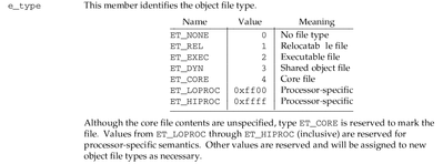

The EXEC_P flag indicates that the section is executable
EXEC_P is a flag that is part of the e_type field of the Elf32_Ehdr structure (the “real” name is ET_EXEC). So you're wrong to say it's a section-related flag!
The same thing applies to NONE
