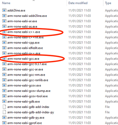

Hello.
In new IDE, new project not founds stdio library.
Programs  "arm-none-eabi-c++.exe"  and "arm-none-eabi-gcc.exe" not present among others in ...\tools\bin directory.
What can be wrong?
Bye,
Darius

They are present in my install.
Check your antivirus software - they could have been quarantined (incorrectly).

Yes! The antivirus was the reason (Avast free)
Switching off the antivirus during reinstall solved the problem.
Thank You.
