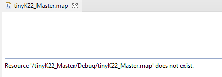

PS: Also... If Eclipse is started with the map file as an open tab, but the map file is not present (for example after a clean), the viewer dies with a null-ptr exception.

about the thing of no-existing map file: With 11.5.1 I get nothing unexpected:
So it could be something which has been fixed meanwhile.
