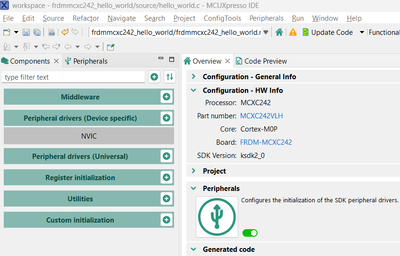

in your dialog, if you click on the "USB" icon, does it open the Peripherals perspective for you, or not?
Also other possibilities there are available:
- in the main menu there's ConfigTools menu and "Peripherals" in there.
- context menu on the *.mex file in the "Project Explorer" has also the "MCUXpresso Config Tools" containing the "Peripherals" item which should open the right perspective.
Libor

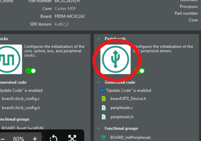

Transidico
hi,
no I don't have the USB symbol (as you can see in the attached picture).
if I try to open it, it does not open for me.
The indicated solutions are not successful, do you have anything else you can point me to?

liborukropec
you have:
... and ...
If it does not work, look to the <workspace>/.metadata/.log file if there are some exceptions. If yes, please attach here.
Does it do a with a clean, brand new example hello world? I tried (MCUXpressoIDE_24.12.148) and it works (SDK 24.12.0):

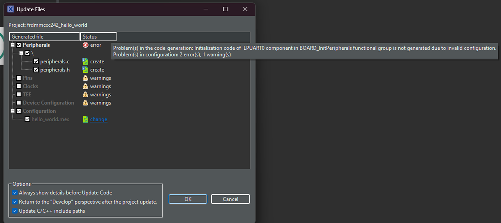

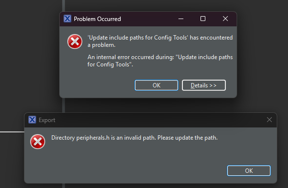

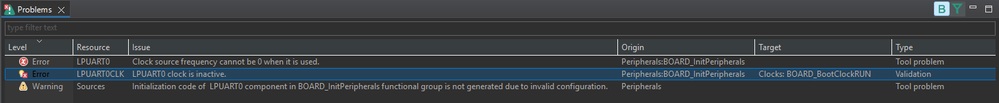

Transidico
If it can be useful:
Screenshot 2025-03-04 170246.pngScreenshot 2025-03-04 170312.pngScreenshot 2025-03-04 171220.png

liborukropec
yes it is, if you click on "Details" button, what is written there? I believe there will be an exception in the workspace log (my other post)
Libor
