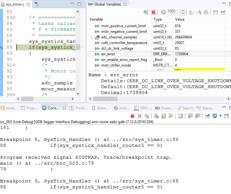

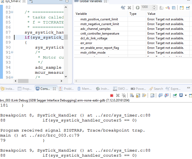

I was able to see global variable values and their change while running code on LPC11c24 evaluation board using debug probe on the board (OM13093_LPC11C24_EVAL_BOARD). I use now J-Link Base probe and cant see global variable values/change. Values are shown only when application is paused:
application running
application paused:
Any idea why global variables do not behave the same way as with OM13093_LPC11C24_EVAL_BOARD on board debug probe ? Do I need to change settings in Segger J-Link debug probe ?

The Live Variables functionality, as described in section 3.4 "LinkServer Global and Live Global Variables" of the MCUXpresso IDE v10.0.2 User Guide, is part of the "LinkServer" debug support - which functions when a "non-stop" debug connections is made.
Unfortunately, this is not available when using SEGGER probes (as mentioned in section 3.9.1, "SEGGER Differences from LinkServer Debug" of the MCUXpresso IDE v10.0.2 User Guide).
It is also not available using P&E Micro probes, though P&E provide an alternate mechanism via another view that their plugin provides (described in the PEMicro Blog).
