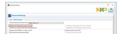

there is one error in SDK user manual, " Ensure Redlib: Use floating point version of printf is selected
" during project creation does not work.
The default C library Redlib doesn't support floating, so it couldn't work with redlib.

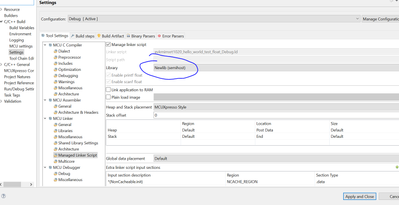

(1)Change link library to NewLib, it's full C library and support float  printf.
But notice need include <stdio.h> in related c file, or else sprintf(float) doesn't work as expected.

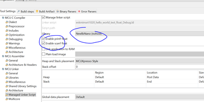

(2)Change link library to NewLib Nano, it's compact C library , and need click "enable print float" to enable float function, which actually add " -u _printf_float" link symbol.
So the solution surely add flash & RAM consumption in project, but for i.MXRT series it's not problem.
