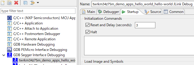

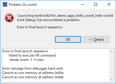

I started develop the new project for MKM34Z256VLL7 using TWR-KM34Z75M and J-Link JTAG ICE.
I used MCUXpresso IDE v10.1.1 [Build 606] [2018-01-02], I believe that it is latest version.
But I have the following error, then I cannot debug using J-Link.
The Initialization Commands of Startup tab has "monitor reset" command as below.
I can debug using J-Link after remove "monitor reset" command as below.

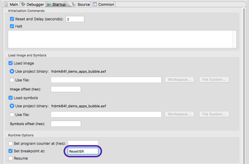

The "monitor reset" command is included because generally it is needed for a successful connection. See SEGGER's J-Link documentation for more details of this command. But if you have found a particularly situation where removing it allows your debug connection to work, then simply remove it and resave the launch configuration. The modified version will then be used by your project for future debug sessions.
You will find more information on what is going on during a debug connection in the Console view, in particular the JLinkServer console. This may give you some clues as to what is actually happening in your setup.

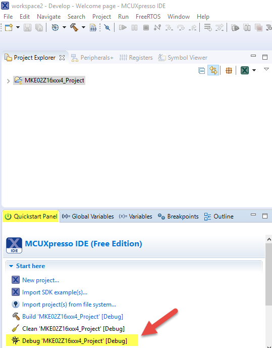

Hello Isao Takashima ,
 Please use the "Quickstart Panel" -> Debug [project ] to  debug your project :
About the detail steps you can also refert to "MCUXpresso_IDE_User_Guide" -> 10. Debugging a Project

isaotakashima
Dear Alice Yang,
Thank you for your reply.
I find out the below screen shot, no "monitor reset" command.
Then I can remove "monitor reset" command from window of Initialization Commands.
There is no other information, I cannot find a clear answer to my questions.
