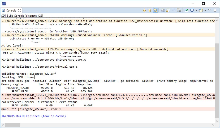

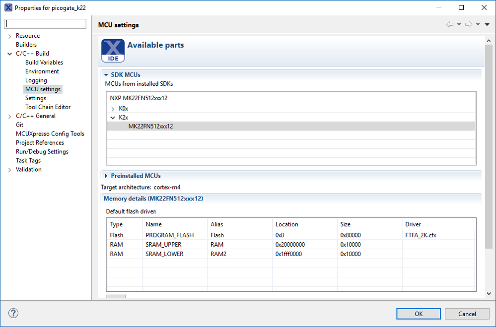

K22 SRAM is split into 2 64K segments.
Currently the linker is only using SRAM_UPPER.
How should i change the MCUXpresso settings to:
a) merge the SRAM into 1 128K.
or
b) evenly distribute across both segments?

This means your RAM memory has overflowed. You cannot mearge this two RAM into one because it could cause you bus problems. My recomendation is that you place some data memory in the lower ram manually with a Macro definition in #include "cr_section_macros.h" for example
__BSS(SRAM_LOWER) uint8_t s_currSendBuf2[]

Initially the linker put all my data into SRAM_UPPER, which causes it to overflow.
So I did what you suggested, I put __BSS(SRAM_LOWER) in front of a big float array about 28k size; after compiling I found linker put all data into SRAM_LOWER, which definitely causes another overflow.
How to make the linker to put the rest data in upper RAM without manually adding __BSS(SRAM_UPPER) for rest data? I have a few dozens of them.
