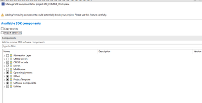

Hello NXP support,
I want to generate files needed for my project. But I can't select a specific location for generating the source code.
Could you tell me how to configure the generated content (.c, .h files) to specific location.
Thanks!

I'm using ver 11.10.0.
I want to generate code from SDK management to a specific folder let's say it's "SDKGenFolder", how to achieve this?

Note that the IDE does not generate SDK-specific files but imports them using rules and directives defined in a dedicated manifest file. Target/project folders are not configurable.
Adrian

I got it, can you tell me where I can find those manifest file? It will be more easy to me when I can customize which files I want in my project template.
488 Views
AdrianOltean
The manifest is inside the actual SDK package. There's no reason to change anything in there, unless you're willing to experiment unexpected behaviors/failures.
You can either import an example project from an SDK, either use the New Project Wizard to create a bare-minimum project. In all cases, you can use the SDK components manager from the IDE to add/remove SDK components.
