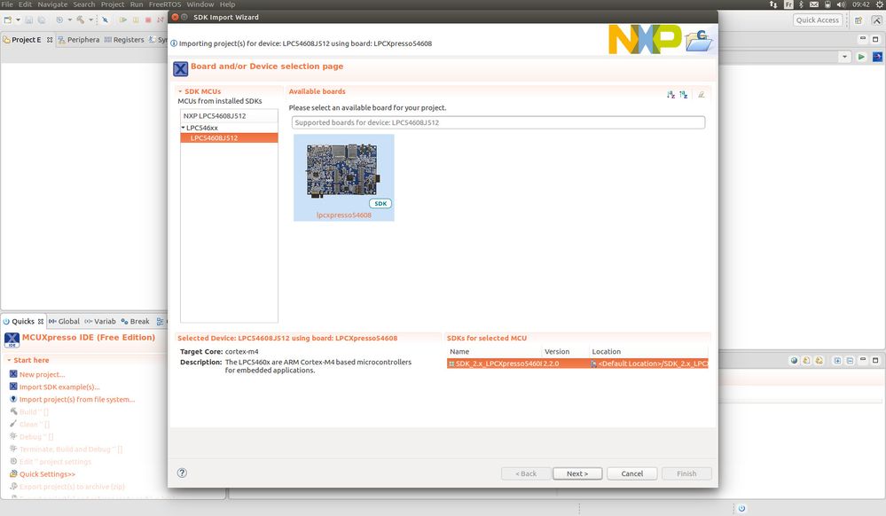

I've just installing my new LPCXpresso54608 board and the MCUXpresso IDE.
I created the SDK for the MCUXpresso via the website (Select Linux), downloaded it and installed it under MCUXpresso.
When I try to install the SDK examples via "Import SDK Examples...", the first panel show me correct informations (it shows the board), when I click next I get an empty panel, no examples are shown.
But when I import the same SDK on my Windows machine (WIN7_64), all is right, I can see the examples. On windows, the SDK works whatever I select Linux or Windows on the SDK builder. On ubuntu, nothing.
Is it a bug or I'm doing something wrong?

Hi Olivier
are you launching the IDE with the launcher or with binary from command line? Could you provide a screenshot? Thanks

Hi support,
Thank you for replying.
I'm launching the IDE from the desktop, I've just tried to launch it from command line as a user and also as root, same result. When launching from console, no errors are printed.
Here are screnshots:

Hi Olivier,
this seems to me as something overrides the SWT_GTK3 variable set by IDE. It needs to be set to 0 for the IDE to function properly. Did you install the IDE according the installation guide?

Hi Olivier,
you can try to run this - export SWT_GTK3=0 in bash and see if it corrects the behaviour.

Hello Ahoy,
Waow, that did the tricks. Thank you very much for your support.
To understand what's the problem I looked for org.eclipse.swt.internal.gtk.version(Help -> About -> Installation Details -> Configuration Tab), without the export I had 3.18.9 has value, and with the export I have 2.24.30
Thank you for this fast and successful support.
