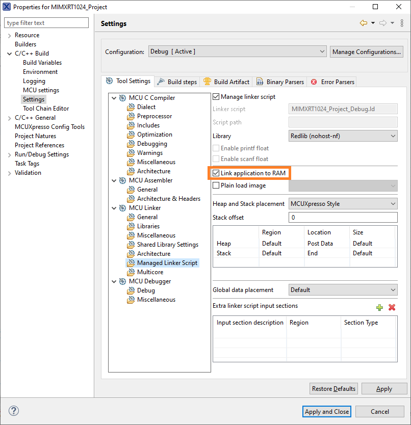

Hi everyone,
I'm using a MIMXRT1024-EVK board, MCUXpresso 11.5.0 and SDK 2.11.0.
I'm trying to use this device in various cases, I've successfully compiled and debugged a project running both in flash and internal ram.
Now I'm trying to do the same thing in external SDRAM, but with no success.
I've modified the project settings:
biafra_0-1643195631284.pngbiafra_0-1643195631284.pngbiafra_1-1643195739354.pngbiafra_1-1643195739354.png
The project is correctly built and linked to SDRAM:

Based on this post, I've modified the lunch configuration settings:
The RT1024_SDRAM_Init.scp attached file is modified compared to RT1050_Debug_Connect.scp file referred in the post due to different registers addresses.
When I start to debug the project I can see that it refers to SDRAM (the current location is at 0x800005F6), but all the SDRAM content is 0 and I can't even modify it.

What am I missing to debug a program in SDRAM?

biafra
Senior Contributor I
Hi @kerryzhou,
Sorry for the delay, I was engaged in another activity.
I've found the cause. In the RT1050_Debug_Connect.scp the configuration for the DQS pin is done using the SION bit (unlike all the other pins), setting the register value to 0x10.
In the RT1050 device the configuration register for the DQS pin is on the register IOMUXC_SW_MUX_CTL_PAD_GPIO_EMC_39 at the address 0x401F80B0.
In the RT1024 device the configuration register for the DQS pin is on the register IOMUXC_SW_MUX_CTL_PAD_GPIO_EMC_28 at the address 0x401F8084.
With the correct settings, I can debug fine in SDRAM.
Now this is my question: why is it needed to set the configuration register for the DQS to the value 0x10, unlike all the other SDRAM pins, for which the value 0x0 is used?

kerryzhou
Hi @biafra
  Please check these points:
1. XIP_BOOT_HEADER_DCD_ENABLE=1
2. stack location modify from end to start
Then test it again.
Please try it on your side.
If you still have issues about it, please kindly let me know.
