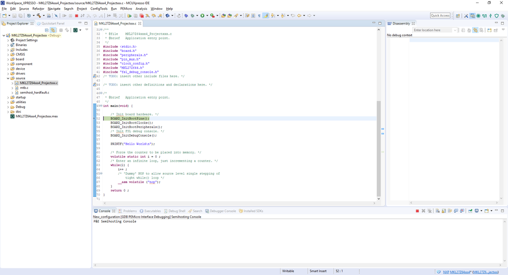

In the debug perspective I can't use the restart button, due to fact it's not enabled.
But in the customized perspective it's still enabled. There is something different to set ?

So we are still unable to replicate. Our assumption is that something you have done in modifying your views / perspectives must have triggered the problem (though we don't yet understand what).
It might be helpful if you could create a completely new workspace, use the standard Develop perspective, and debug a standard project. Can you confirm if restart then works correctly?
And if you then import your actual project into that new workspace  (but delete the .launch files) - does restart then work correctly?

lpcxpresso_supp
We cannnot reproduce any problems with the Restart button.
Please can you try selecting different levels within the Debug View, and see if this causes it to be reenabled. Please also confirm what host OS you are running, and what debug probe you are connected through, and to what target MCU.
Also, if you use the right click menu in the Debug View, do you see the Restart option in that menu being active?

claudiobrunelli
I tried more times to change debug level, but this is the result shown in the attached file.
My OS is Window 10 pro 10.0.17134, build 17134.
I'm using the Freedom Board KL27 based on MKL27Z64 and the debug port is the OpenSDA port.
Nothing more.
This problem happen both with my own project and a projects totally generated by the wizard.
Thank you for your assistance.

lpcxpresso_supp
Please confirm that you select the proper context in Debug view. Please attach a screenshot of the entire IDE when button is disabled.
Also, please attach the .log file from your workspace. Maybe we can get a clue of the failure.
Please also provide answers to the following questions:
 1. What IDE version are you using?
 2. What board/MCU are you using?
 3. Is the problem encountered with a new project created with the IDE?
 4. When using the Develop perspective, is the Restart button enabled?
Greetings,
MCUXpresso IDE Support
20,156件の閲覧回数
claudiobrunelli
Good morning and thanks.
1) IDE version is 11.0.1
2) Board is FRDMK27
3) Yes
4) No it's not enabled.
As_soon_as_load_debug.pngAt_StartUp.pngC_Perspective.pngDebugPerpspective.pngDevelopPerspective.pngInfo.png
