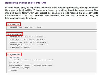

I am following mcuxpresso IDE user guide section 17.15.1 to relocate particular objects into RAM.
I added a linkscripts folder to my project and put 3 linker script templates in their as advised (main_text.ldt, main_rodata.ldt and main_data.ldt)
Clean project and build, but I get a linker error message that says "cannot find main_text.ldt", but the file is definitely there.
Is there some steps missing from the user guide? Or did I miss something else?
I took a look at the flash_component_nor example project and noticed that the files in the linkscripts folder for that have different names (bss.ldt and data.ldt) but the main_text.ldt is the same.
many thanks
-Nick

In the end, this was a typo in the linker script files.
I followed exactly what is said in the user guide, but it turns out that the 1st line of the examples should not be in the file.
Perhaps the documentation could be clearer?
-Nick

lpcxpresso_supp
We'll update the doc to avoid this confusion.
