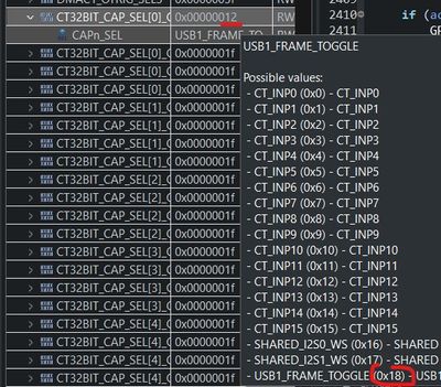

Mcuxpresso 11.5.0, RT685, problems with register view:
1. Offline view should always show possible values.
Example: when hovering over the reset value of clkctl1->flexcomm[0]_fcfclksel possible values are shown. When hovering over inputmux->sct0_in_sel0 reset value no 'possible values' are shown but they are defined in the svd file.
2. Possible values in 'online' register view sometimes have the wrong prefix.
Example: inputmux->ct32bit_cap_sel[0]_ct32bit_cap_sel0 possible values have 0x prefix but are the decimal values.
3. The svd file contains  'cluster' definitions with an address offset tag. This tag is ignored and the registers are shown with the wrong offset which obviously causes problems. The svd file itself is correct, the offset is properly parsed when loading it in Segger Ozone.
One example (there are more...), the flexcomm0 frgclksel register is shown with the wrong offset (0x40021000 instead of 0x40021500) :

Hi & thanks for fixing issue number 3 in 11.5.1. The first two issues still exist. They are not urgent, but I thought I'll add a screen shot so you know what I mean by 'possible values'. Either the 0x needs to be removed or the hex value should be printed.

Note the wrong register address. Does not change when I load the svd file from https://github.com/NXPmicro/mcux-soc-svd
