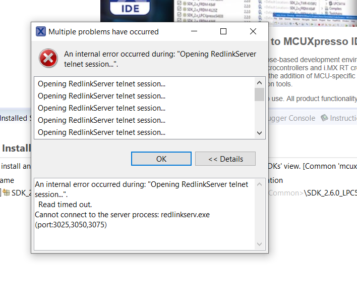

Can somobeody help me?
I have Windows 10 and now I make new installation MCUXpresso V11. I have a problem with Redlink server.
I tried to do with V10. The problem is the same. When I install Windows 7, Redlink server goes without problem...

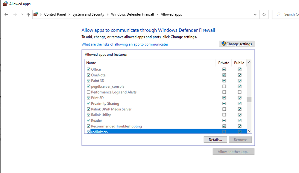

Looks like your anti virus software is blocking the connection. Change the settings to allow red link server to establish connections.

I turned off antivirus and it doesnt work. Then I uninstalled antivirus and it doesnt work too.

Do you have the Windows Defender Firewall? You need to allow the redlinkserver application to have network access.
See the picture
