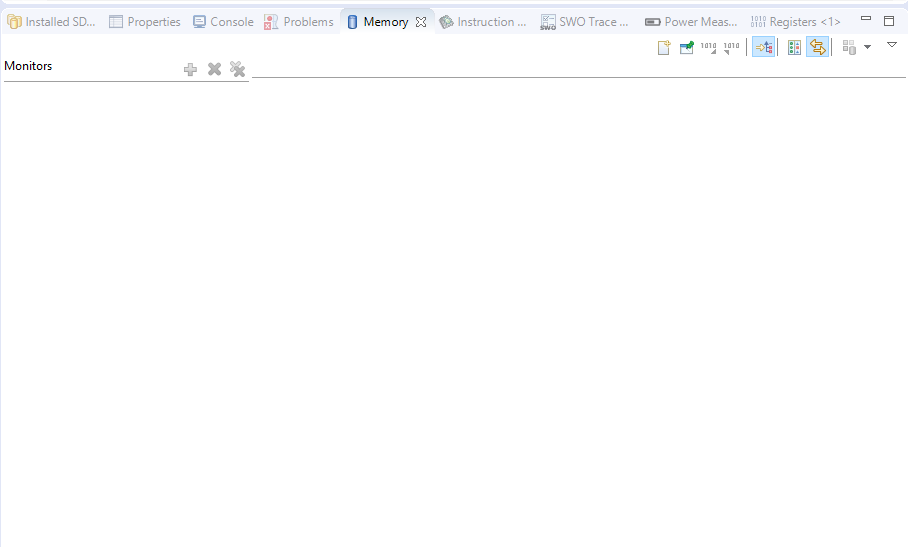

But I can't find the option in MCUXpresso to read the code from the chip. I am using the LPC-Link 1 for this.
3,617 Views
lpcxpresso_supp
I suspect you aren't currently connected to the target -> You need to have an active debug connection down to the target MCU in order to view (and hence save) memory.
This can either be a standard debug connection, or if you have already got everything programmed down to memory, you could start an attach-only connection (see section 10.3.1, "Connecting to a running target (attach)" of the MCUXpresso IDE v10.1 User Guide for more details).
Then once the target is paused, open a Memory view onto the start of flash, and you should then be able to save.

I have tried your options. I would really like to use the first option with the memory exporting but I can't click on that function, it's not active.

You could use the memory view, as per:
Or it might be easier to convert each of the AXF to s records (or similar) which you can do using the supplied objcopy tool (as per MCUXpresso IDE v10.1 User Guide section 16.11,"Creating bin,hex or S-Record files"), and then "merge" them - for instance using a tool like "srecord" (external link : SRecord 1.64 ).  You might find this article helpful too : Merging S19 Files | MCU on Eclipse
