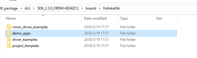

With the downloaded and installed (default) boards:-  SDK_2_x-FRDM-KE04Z  Ver 2.3.0
When using the MCUEpresso IDE   'SDK import wizard'
I'm seeing No examples to import listed
(and therefore unable to continue)
The above SDK has examples in its folders
Please advise.

Hello George,
Development expert said
the resource is very limited in FRDM-KE04Z, so all of our SDK examples cannot even succeed build for MCUXpresso IDE. So, FRDM-KE04Z does not support MCUXpresso IDE.
I checked other toolchain SDK package, for example KDS, IAR or MDK, they includes demo code,
I think you can create a new proejct on MCUXpresso IDE, then refer to the demo code on other IDEs.
Hope it helps
