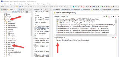

Hi, what does the asterisk icon decorator mean in Project Explorer ?
see attached png

Hi @fractalgarden ,
This one means that you have that folder under version control (git I assume) and that you have made changes to files in that folder, and that you have staged something from the folder (file), but have not committed it yet.

Hi @fractalgarden ,
