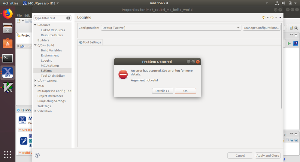

Hi there,
I am trying to configure MCUXpresso for building FreeRTOS applications for ARM Cortex-M4 on i.MX7 following the indications in Tutorial: Building FreeRTOS Applications for ARM Cortex-M4 on i.MX7 with Eclipse | MCU on Eclipse .
Everything seems to work fine when MCUXpresso runs on Windows 10. However, I get the error below when I try to configure the project settings when running on Ubuntu 18.04.
Having a look to the .log file, I find the following:
!ENTRY org.eclipse.jface 4 2 2019-02-05 15:23:58.653
!MESSAGE Problems occurred when invoking code from plug-in: "org.eclipse.jface".
!STACK 0
java.lang.IllegalArgumentException: Argument not valid

I found a similar error in eclipse forums but couldn't make any of the proposed solutions work. Could anyone give a clue of what is going on?
Thanks in advance!

Hi Victor,
You could try verifying the Java dependencies of each package that you are trying to incorporate, in order to ensure that you have the proper Java version and/or permissions.
Hope this will be useful for you.
