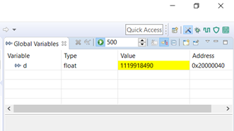

I am new to the MCUXPRESSO IDE and was exploring the "live variables" features. While doing so I encountered that when viewing a live variable "d" which is equal to addition of a few other variables all of type float, the value of d while the program is running is a random number.

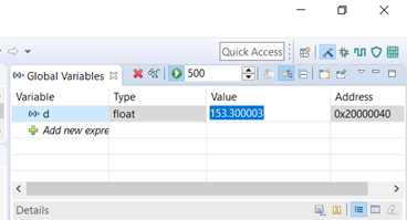

When the program is paused/suspended , the value is displayed in the float format. Why is this happening?

Formatting of floating point numbers in conjunction with "live variables" will be fixed in the upcoming 11.1.0 release.

I have taken a look at this report in version 11.0.0 of MCUXpresso IDE and so far I have not duplicated your results.
Please can you clarify:
The version of the IDE you are using and the host OS?
The Debug probe and firmware you are using? e.g. OpenSDA CMSIS-DAP, JLink etc.
Whether you can demonstrate this with any global float or is the result of additions significant?
The 'random' number is almost certainly the conversion to decimal of the hex value of the variable - i.e. not the float interpretation of the mantissa and exponent.

MCUXpresso IDE v11.0.0 , OS : WINDOWS 10
OpenSDA debugger
The images I had attached along with the query were of a global float
expression.
As you mentioned I too realized that it might be the decimal representation
of the generated hex number. So how do i get to display it in its float
form?
