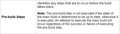

I noticed that if I build a project the pre-build command is always executed (if it is configured) regardless the project is up to date or not.
In the MCUXpresso online help it's stated that the pre-build command is not executed if the project is up to date.

I don't think that's a problem. Even your analysis shows that execution of pre-build steps is part of the "make all" - "pre-build" is added by the managed build system from CDT. I think that the part related to determining whether the project is up to date is actually done from Eclipse/CDT and it has nothing do do with the generated makefiles. In other words, if Eclipse/CDT determines that project build must not be triggered, pre-build/post-build steps will implicitly not be invoked because "make all" is not invoked.
As far as I'm concerned, it functions as designed with one note - it's unclear from the Eclipse documentation what is the strategy used to determine whether a function is "up to date" or not.
