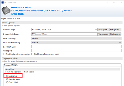

Hi @JM0
I would suggest you try to  perform a mass erase with MCUXpresso in case this issue happens.
