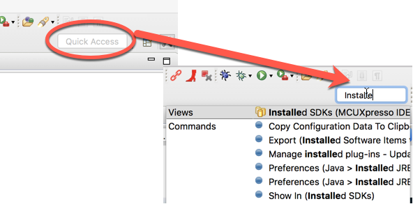

I closed the "Installed SDKs" window, and now I can't figure out to reopen it.  How can I reopen the "Installed SDKs" window?
2,146 Views
lpcxpresso_supp
Simplest way is probably to use the "Quick Access" box (normally in the top right of the IDE window) and start to enter "Installed SDKs", then click on the view when the appropriate entry appears as you type ....
Otherwise, use the menu :
  • Window -> Show View -> Other -> MCUXpresso IDE -> Installed SDKs
