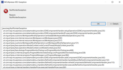

I wanted to add a new driver to my project , so I opened one the "Manage SDK component" and selected the desired new driver, but a popup window appears showing a exception NullPointerException. This error also appears click on the "Refresh SDK Components".
To be honest I don't know what seems to be the problem here. Could you please help me figuring out this issue?
I am using the MCUxpresso 11.4.0
Thank you in advance

Hello joao_ribeiro,
How about download and install the latest version SDKv2.10.
https://mcuxpresso.nxp.com/en/select

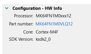

Here is the information you asked about my SDK
To be honest I still have the same problem when adding a different new driver to the project

Hello joao_ribeiro,

Hello Alice_Yang,
Yes using the new SDK should resolve the problem.
It seems that the project got messed up some how. Therefore I am starting a new project with 2.1 SDK and copying the files to the new project.
