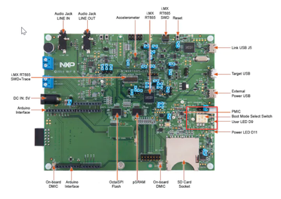

I have just installed MCUXpresso v11.2.1 with SDK_2.x_EVK-MIMXRT685 v2.8.2.
There are no problems building, running and debugging a few of the existing sample Projects such as e.g. the hello World demo. However, when I create a new Project (from the Quick start panel), selecting the MIMXRT685-EVK, with default settings, I can build but when I debug it does not even got to the main function or even the resetISR (as far as I can see). It does not stop on the main breakpoint and when I pause the execution I just get:
Break at address "0x1c04a" with no debug information available, or outside of program code."
I cannot find what the problem is by comparing the working imported hello World sample with the non-working newly created default Project.
Is there some configuration needed not set as default for the selected EVK?

Be sure that the boot configuration is set as default.
ISP0 = 1
ISP1 = 0
ISP2 = 1

Yes the boot configuration is correctly set.
Also, it does work if I import e.g. the hello world project. The problem occurs when I create a new project (with the wizard) even with default settings for the correct EVK. Furthermore, if I open the PIO editor tool, for the imported hello world project, it says that the format is old and it might not work if I save it.
Hence, it seems as if the new MCUXpresso is just not working with the CPU/EVK we are evaluating.

I may be clutching at straws here but it seems to work if I select the board component "flash_config" when creating the new project. At least I now get to the main breakpoint. I will continue to do some tests to see if it is really working as expected.
The "flash_config" is selected for the "hello World" sample Project but not for a default new Project.
