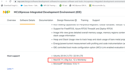

ZhangJennie
Hi jsambrook
I can't reproduce your issue.
MCUXpresso IDE supports MAC OS 11.x. Officially 13.x is not supported. Please use MCUXpresso IDE on our recommended platform.
https://www.nxp.com/design/software/development-software/mcuxpresso-software-and-tools-/mcuxpresso-i...
Have a nice day
Jun Zhang

ZhangJennie
This is anounced on the link I sent you in my first response.
I will escalate as feature request for new MacOS support. Thanks for your comment.
