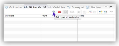

When I enter debug mode and I want to watch a global variable,I open the "Global Variables" view.
It takes too long time to "Loading global variables from build artifacts",and nothing can be done before it finishes.
Is it necessary that every time I open  "Global Variables" view,it loads all the global variables?
Do you have any solutions?

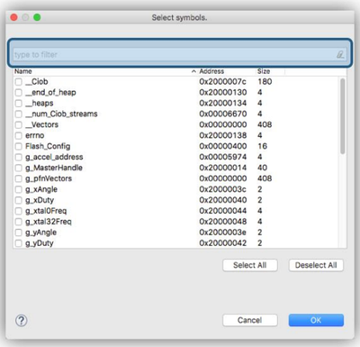

Is it necessary that every time I open "Global Variables" view, it loads all the global variables?
You could select which variables you want to load checking the boxes of the variables you need and clicking OK. To simplify the selection, you could use type to filter to search for the variables you want to select.
[MCUXpresso IDE User Guide. Figure 12.33. Add Global Variables and Figure 12.34. Global Variable Selector]
