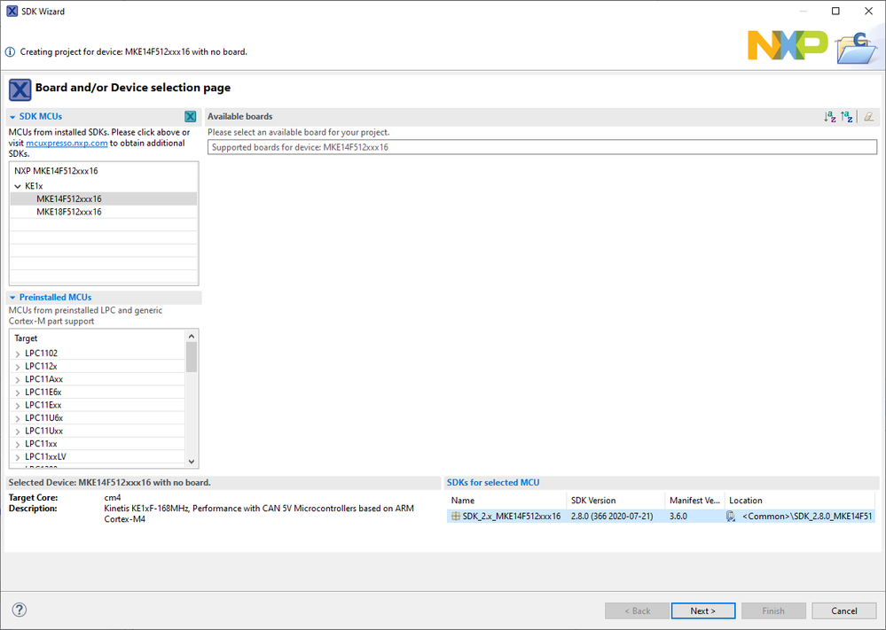

I recently installed MCUXpresso v11.2.0 and created a new v2.8.0 SDK build for the MKE14F512VLL16 MCU and installed it into the IDE. I then proceeded to create a new project by clicking Create a new MCUXpresso IDE C/C++ project in the IDE.
I selected my appropriate device as follows:

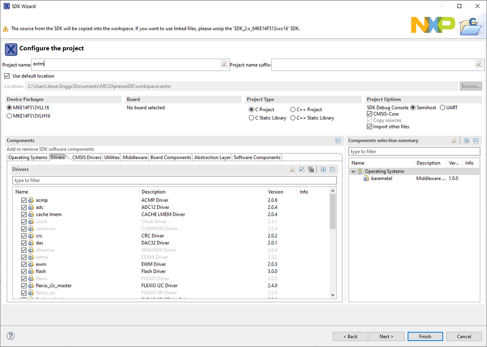

I then selected all of the device drivers for my baremetal project:

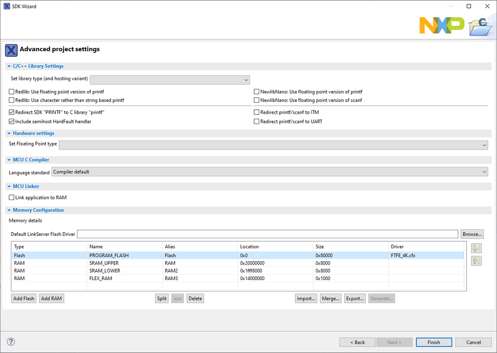

And finally the problem showed up, I'm unable to set a library type or Floating point type for my processor. The drop down menus are blank.
I went through this same exercise using SDK v2.7.0 and I had the same problem so it seems like the problem is MCUXpresso related.  Note that this process worked previously with MCUXpresso v11.1.1 and SDK v2.7.0.
Any suggestions on how to fix this?
Jesse

Thank you for your report. We logged a ticket internally to track the problem. We're planning to have it fixed in the next release.
Greetings,
MCUXpresso IDE Support
